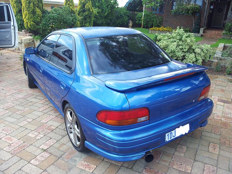

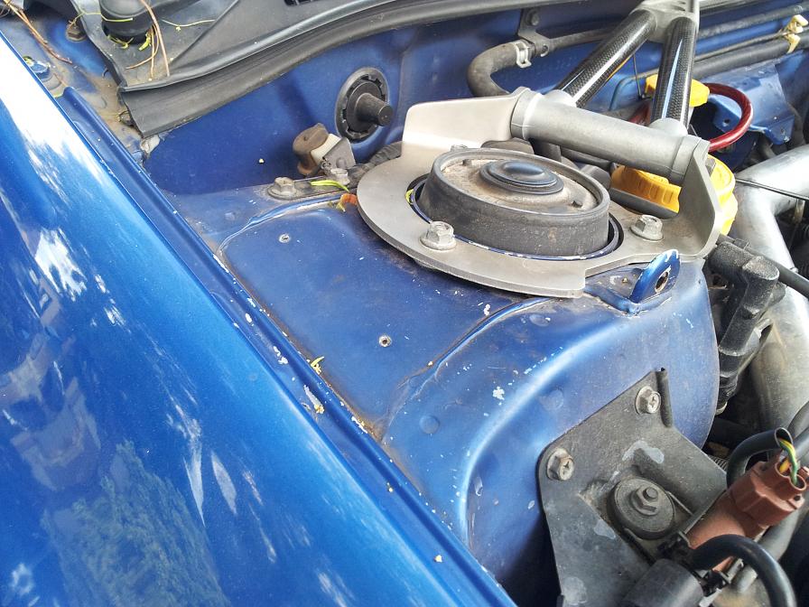

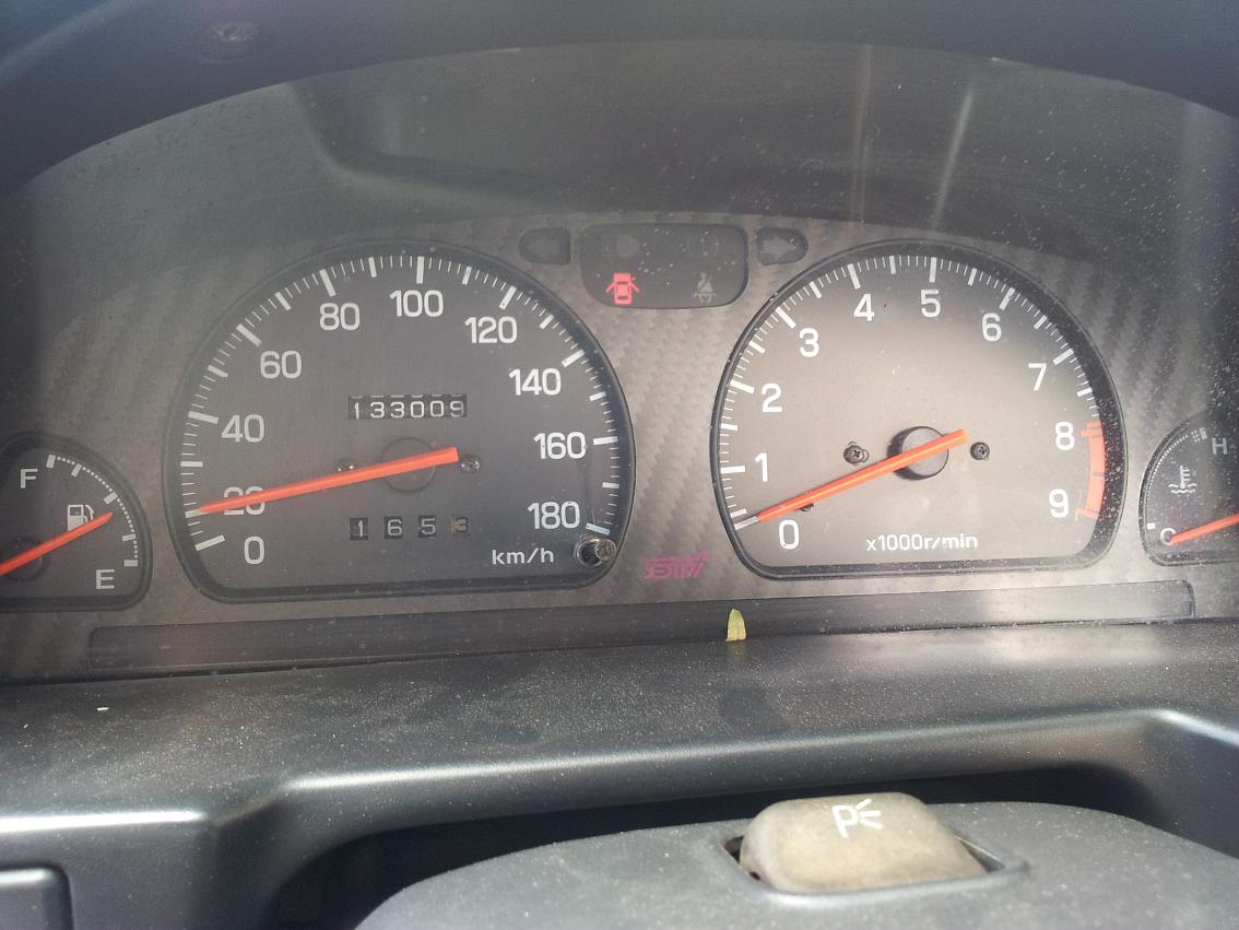

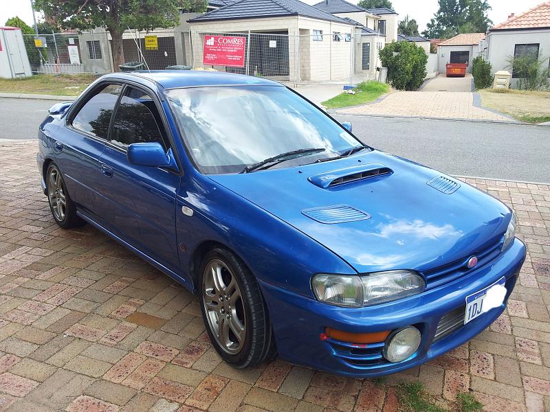

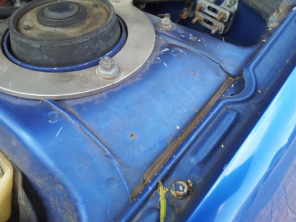

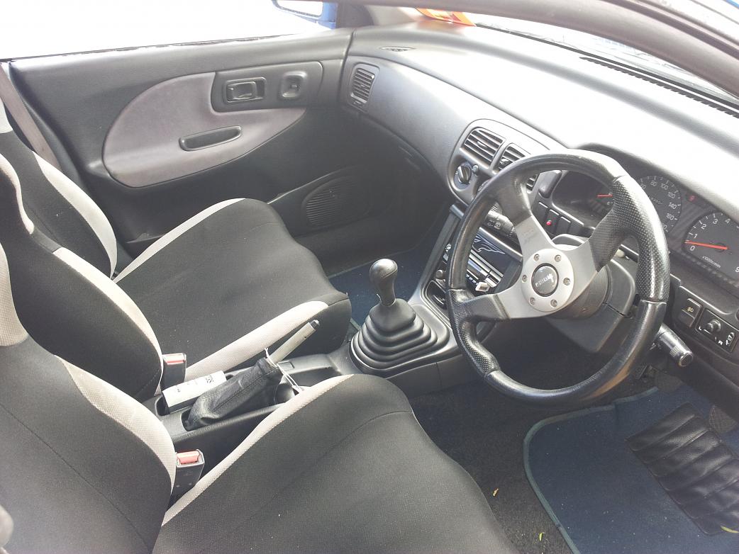

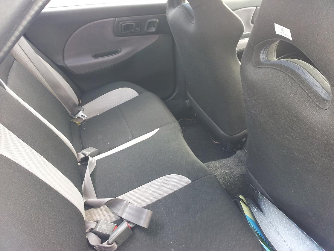

Here are some more pictures of the car (maximum of 5). My dad has like a receipt of the registration for the car, not the whole thing. It shows the VIN and it matches with the car. The rego doesn't show the engine number though.
- 20121229_134842.jpg (119.97 KiB) Viewed 7885 times
- 20121229_134828.jpg (118.36 KiB) Viewed 7884 times
- 20121229_134945.jpg (122.08 KiB) Viewed 7903 times
- 20121229_134923.jpg (106.29 KiB) Viewed 7905 times
- 20121229_134913.jpg (106.04 KiB) Viewed 7908 times
Ok. Seems like a legit wrx, but it's not hard to bolt on all the bits and make it seem proper(something seems iffy). It's definately not a sti. Can tell by the tail lights.
I've got a feeling the body is a standard non turbo impreza with the wrx stuff bolted in. The fact that the compliance plates are gone is a massive concern.

The number plates are also very fresh 1DJV meaning it hasn't been registered with them plates for a long time.

Definitely missing both the compliance plate from the RHS strut tower and the VIN plate from the LHS strut tower.
They both should have the same VIN number stamped on them which matches the chassis number. The chassis number is embossed on the fire wall above the brake booster.
It is a significant issue that they are missing, they need to be there by law.

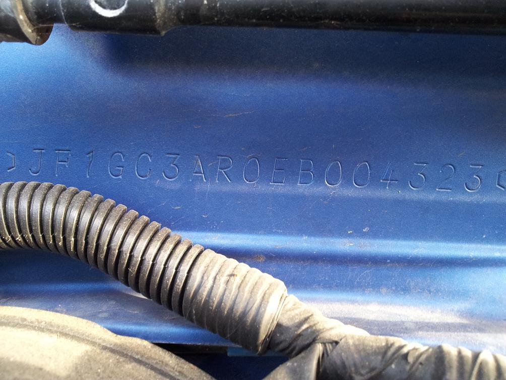

180kmh speedo = jap import cluster
You need to find the chassis number that is stamped into the firewall like this
The image is of a Liberty, but the location should be similar.
It will tell you what the chassis was originally and is near impossible to remove.
It seems very odd that there are no compliance plates, if the car has been re-complianced, there will be a new plate somewhere that will start with a 6.
Normally early Impreza's will have a vin like "JF1GC3xxxxxxxxxx" or "JF1GC5xxxxxxxx"
WRX's will be like "JF1GC8xxxxxxxxxxx"
If its an import it will be simply GC8xxxxxxxxxxx" without the "JF1" at the start
Ok so it appears to be a Australian delivered 1993 1.6L sedan with a FWD 5 speed manual transmission.
Im guessing that because the rear brakes are discs the brakes have been upgraded. 1.6L models didnt have ABS and thus had drum brake rears. It was also necessary to upgrade because the drums wouldnt have worked with the AWD rear end.
Can you take one front wheel off and take a few photos of the front calliper so we can confirm that the front brakes have been upgraded to 2 pot callipers?
On the back side of the calliper, you will either be able to see one piston or 2.
