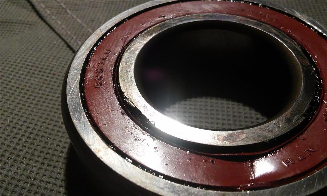

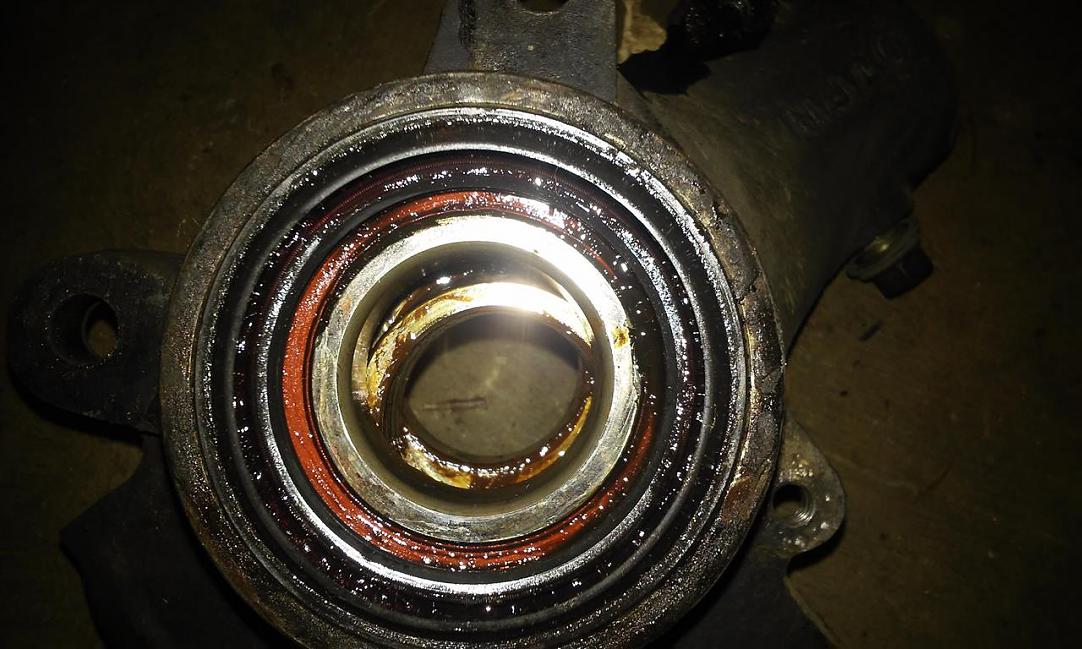

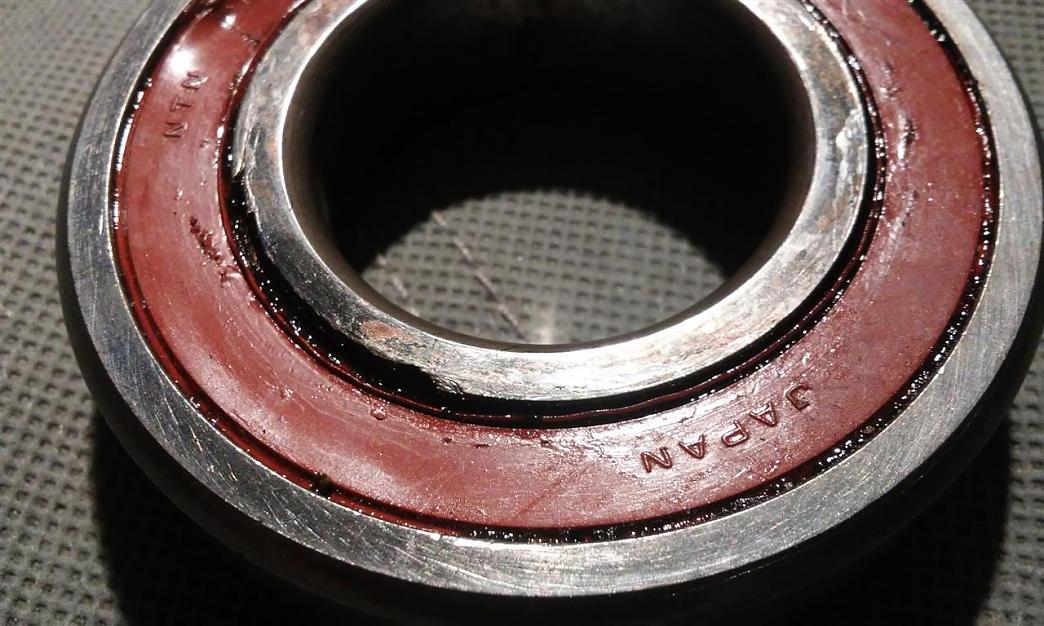

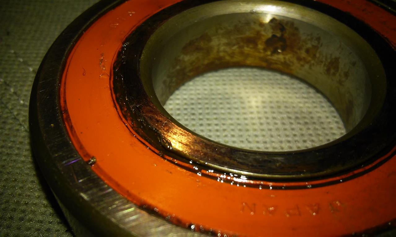

Amazing, right on cue - 12 months old and the sealed bearing fails!
A mere 3 weeks after I do the passenger side, and the drivers side started growling on Monday night :evil: By tonight the noise was scary. The last set of sealed bearings left on the car, been in there 12 months at the most. Exactly the same thing happened as in 3 weeks ago on the other side. Grease leaks out, bearings overheat, inner bearing race is missing chunks and full of cracks. With the bearing out of the hub, spinning it by hand I can feel the tight spots and sometimes it gets jammed in one spot.
Replacing with open bearings tomorrow morning. After the same thing happening with 3 different sets of bearings, safe to say I'm sticking to the open type from now on.

That doesn't seem right. I've seen grease dryer than that on worn bearings.
I'd be wondering why the bearings leaked the grease. Has the vehicle seen any water crossings?

Post by Silverbullet » Fri Oct 07, 2016 8:50 pm
Bennie, the process you describe is no doubt a good one to follow and I'm sure your bearings will last a good while. I'm wishing I had done the same to my sealed units.
But, the whole point of sealed bearings is that you shouldn't have to stuff around picking them apart, cleaning the grease out and re-greasing them yourself :twisted:
An interesting comment just popped up on the FB post I made about this:
NTN 6207LU - they're designed for motors not cars. They withstand upto 11,000rpm but they don't like rough ride or abuse as they get damaged very easily.
If that is true it explains alot, and also that I've been sold the wrong thing 3 times :rolleyes:
Also I think having the rear bearings as sealed units is impossible due to their construction/design, very different to the fronts.
