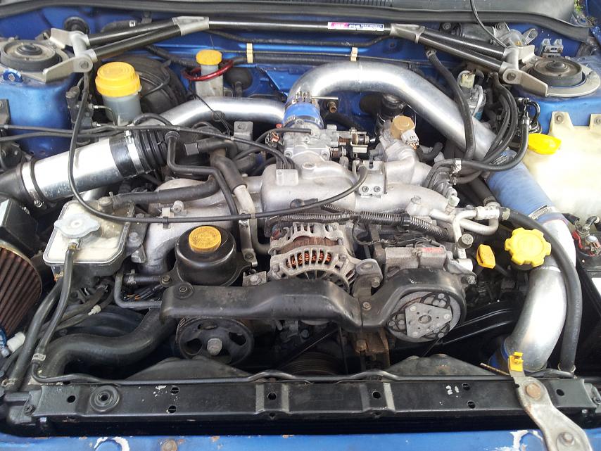

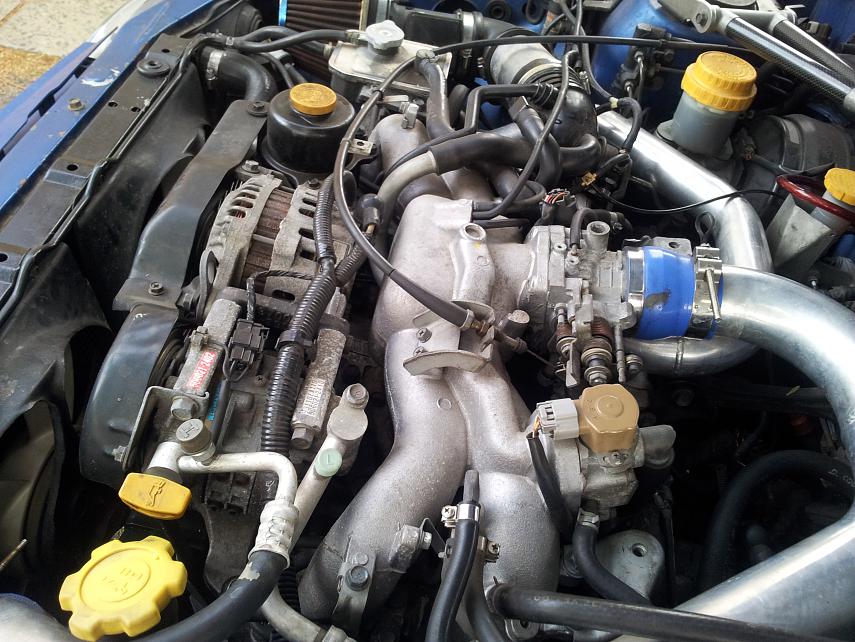

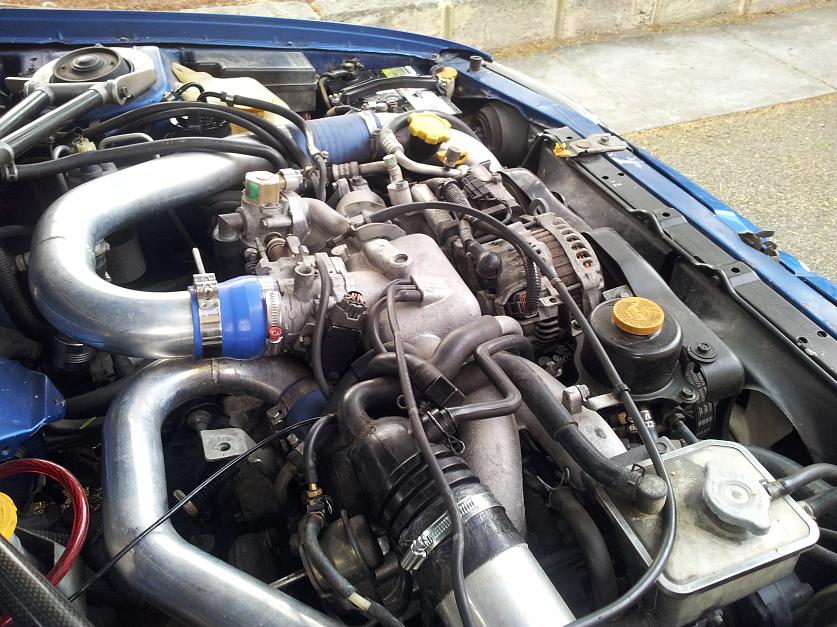

I can see the bar code on the timing belt cover but it is in a difficult spot to read. Here are a few pictures of the engine.

Looks like some aftermarket work. Pod filter cough stainless pipes cough :)
An I right in thinking that ALL WRX and STi are turbo engines? And then the STi is just tuned?

Post by TOONGA » Fri Dec 28, 2012 8:41 pm
doesn't look like an STI motor normally they have a red intake manifold and a top mount intercooler with STI written on it

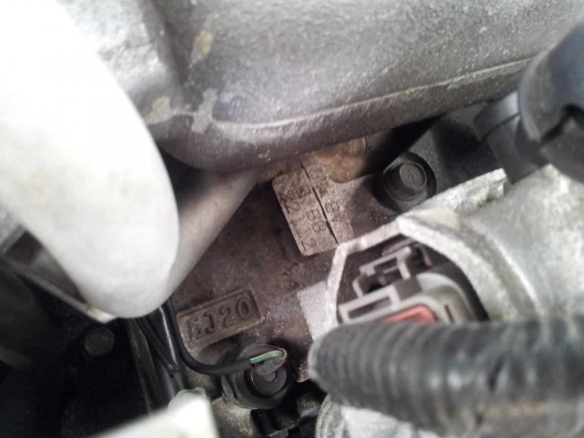

You have an intercooler but no turbo.
Can't spot one. And if there wa it would be aftermarket. Note engine number EJ20 not EJ20T.

Have a close look at the motor Cam it is the quad cam motor as everyone calls them, Ive never seen an EJ20 quad cam run N/A.
the EJ20 motor never has been named with a "T" EVER the T designation comes from us the buyers of subarus not Subaru.
Even the fabled EJ22t motor only has EJ22 written on the block.

Post by Alex » Fri Dec 28, 2012 10:00 pm

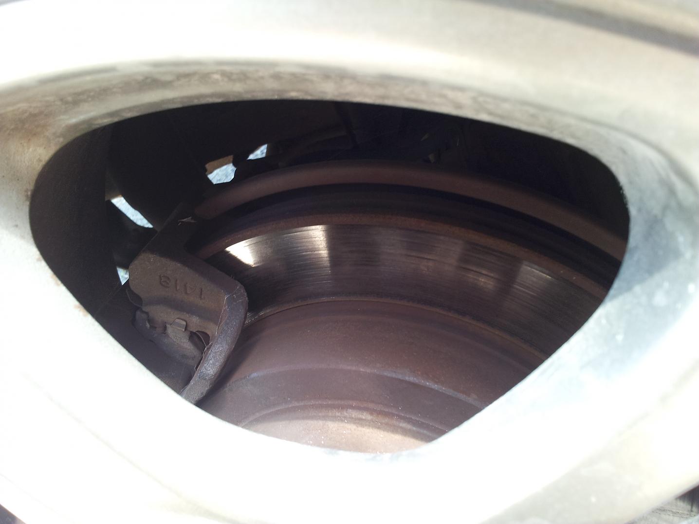

There's definately a turbo there. Can see it in the last pic. It also seems to be an Ej20g from a gc8 or liberty rs.
Can pretty surely say it's not an sti. Got any pics of the wheels and brake calipers? This is another good way to determine how good the conversion is.

Yeah the car has turbo. I can tell with the power it has plus I can hear the BOV. I will take a picture of the wheels and brake calipers tomorrow morning. All I can say for now is that all 4 wheels have disc brakes. In the Sti version, is the motor the only thing that's different from the standard WRX?

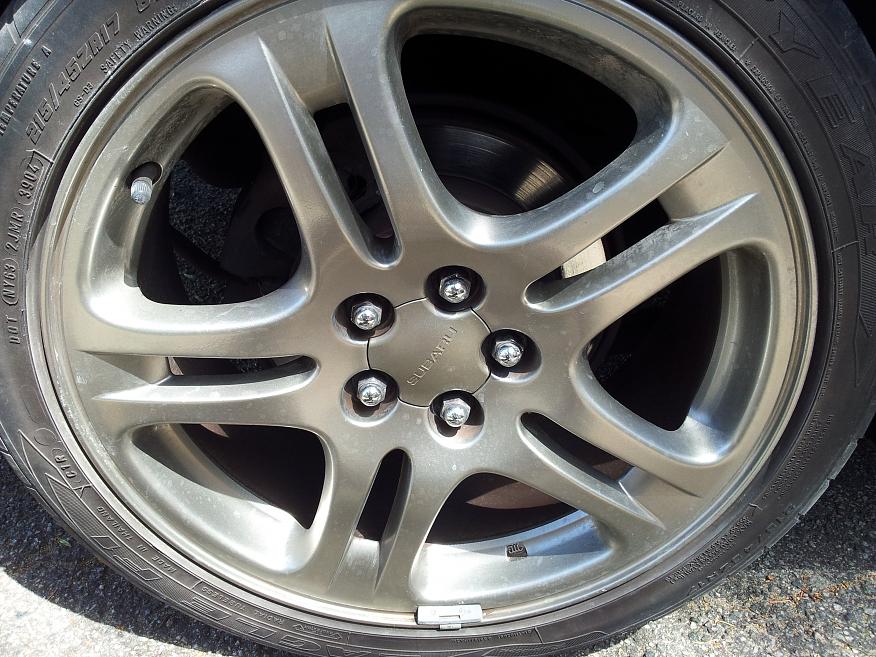

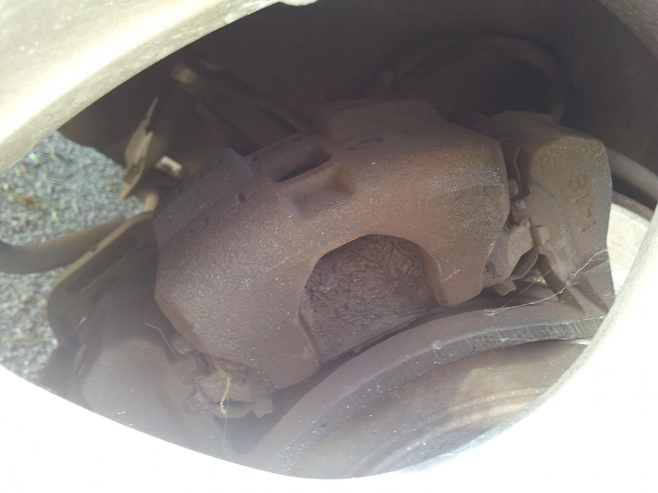

Alex wrote:There's definately a turbo there. Can see it in the last pic. It also seems to be an Ej20g from a gc8 or liberty rs.
Sent from my HTC Sensation Z710a using Tapatalk 2
Here are a few pictures of them. All four wheels/brakes are the same.
