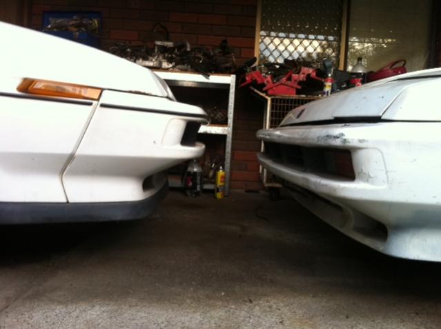

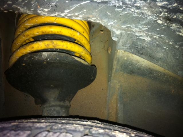

This is why the turbo handles like a gokart.
This is the height differance with the two cars. Turbo is the taller one.
The Auto has standard springs and also handles like a go kart.
Cheers Pete

Post by steptoe » Tue Jun 21, 2011 1:07 pm
sure you don't mean 'billy cart' ?
Yellow springs used to be Selbys colour, a name being resurrected in sway bars by Fulcrum.
Pete, you got a measure of each wheel centre to the top of the wheel arch on both would be handy

The heights from center are
The turbo height is 38cm or15 "
The auto height is 33 cm or 13"
These are the front guard heights
Strangely the diff on turbo is about a coke can off the tarmac.
Cheers Pete

Post by steptoe » Tue Jun 21, 2011 7:15 pm
OK, thanks, your turbo is spot on to RTA spec as a minimum 380mm.Must have borrowed yer missus sewing tape eh? cm? At the front mine is 385mm and just found the wrecker markings EA82 sed FI 2WD sounds like a Vortex or were there also 2WD sedans with FInjection? Replacing air bags that was......
Holding on for rear guard to centre measures of the turbo...cm will do :)
Gone lookin' for a Coke can but think same as beer can
Front mins for FWD is 345mm, so yours has settled a bit, rear mins 285mm

Post by coupe » Tue Jun 21, 2011 9:08 pm
Lol Damn these people who cant think in imperial.
Turbo rear is 33 cm, the auto is 30 cm.
Yes they made a fwd mfi sedan 1985 onwards. they were called Royale.
the spring length on the rear of a standard shockie is 28 cm assembled.
Cheers Pete

Post by steptoe » Wed Jun 22, 2011 9:57 am
Pete, thanks. I really need to transfer these details I have here written on poo paper, just on the perforation, bits are missing of the figures.Your measures make your Turbo Vortex at the acceptable height for rego purposes and possibly as it left the factory, mine however has another two inches on your 33 cm. Your FWD is half an inch higher than spec?
Royale, think I have seen one. Coincided with a Royal wedding?
I measured my assembled freeload springs at 27 cm not allowing external casings, both size springs plus 40mm and plus 50mm. Not measured coil wire thickness yet.
