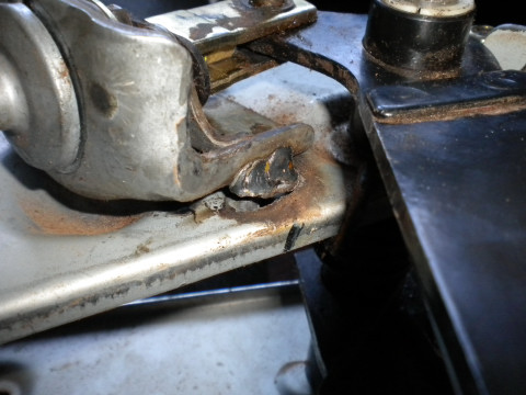

Finally got around to looking deeper into the issue and I can see what the problem is. I just want to confirm that the clutch box you guys were referring to is the little C shaped thing immediately behind the clutch pedal assembly. Is that right? And are they usually welded into place? From what I can see from looking into it, the tack holding the box to the spar behind it has cracked and it is flexing forward every time the clutch pedal is depressed.. It looks to me like all I need to do is retack that into position and it should be sweet.. Does this sound right to you guys? Bitch of a spot to weld though. any hints?

you would need to pull all of the pedals off weld plates on the internal sides of the box where the cable holds into and on the opposite sideCreamfeeder wrote:Thanks for the pics, Toonga, that has cleared things up immensely, thats exactly what has failed on mine. One question though, people have been mentioning welding on some flat bar to strengthen it. Where would I weld this on?

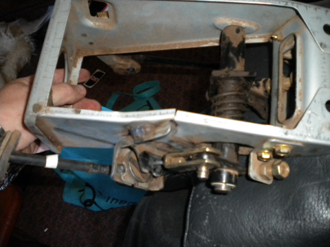

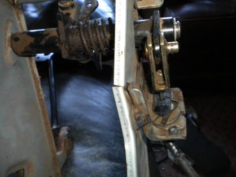

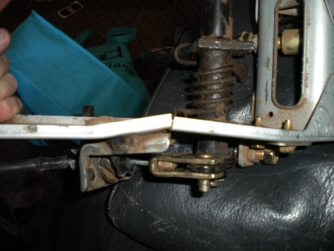

hi guys, thanks again for all your help, I have managed to pull the offending item out of the car, not an easy job, and now just need to get it fixed. I've attached some photos to show the faults so you guys can give me your opinions.

yep the last one i saw like that i threw in the bin (it was mine) I would concider getting another pedal box but if you can't then you are in for a welding good time and it looks as if someone has welded it up before as those welds are way bigger than the ones on mine ( i just went and looked at it in the shed)
