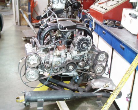

I think Adrian may be onto something there, here is a pic of a EA81 with dual cam heads.discopotato03 wrote:Who knows , maybe Fuji was saving development dollars for later things - like a flat four with more than three main bearings .
Its still a EA81 shortblock, but it has hand machined heads, a spider type throttle body with fuel injection and an interesting, equal length exhaust header setup
Id love to know the story behind this picture

That dude is Checkers. I suppose comapring an EJ in its own body, with its own gearbox and brakes is not the best way to assess how same will go in a lighter MY or L series either. Maybe it is the delivery of power and torque from the EJ that is more noticeable than the actual figures, especially in the lighter bodies
The story behind that picture ???
Looks not like Subaru development environment, more like an aircraft setup using twin cam Fiat heads - the front half of two. Don't think the Alfa boxer ever did twin cam. Maybe the engine builder is still chuckling away with Subie nuts around the world salivating at his build up that will never run - just clearing some crap outta the shed along with a few mates and tinnies
