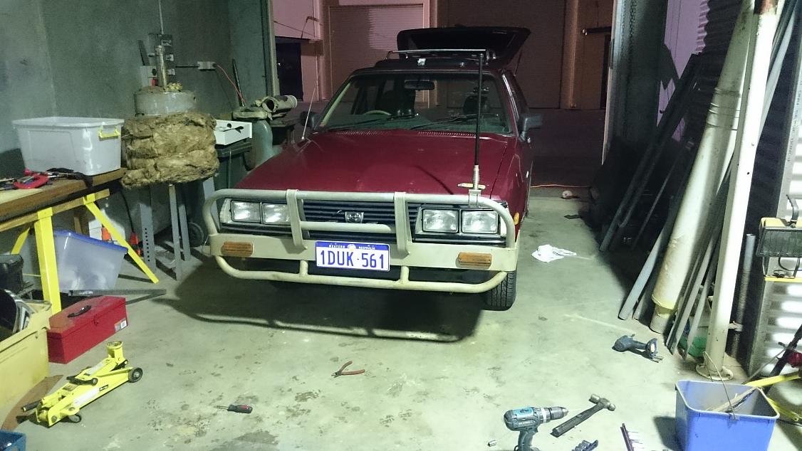

Got some goods off of ClassicJay, cheers again mate,
Front roo bar, Little bit better then the old one. Was a little bit twisted and still is but meh, will fend off the skip's just as well.

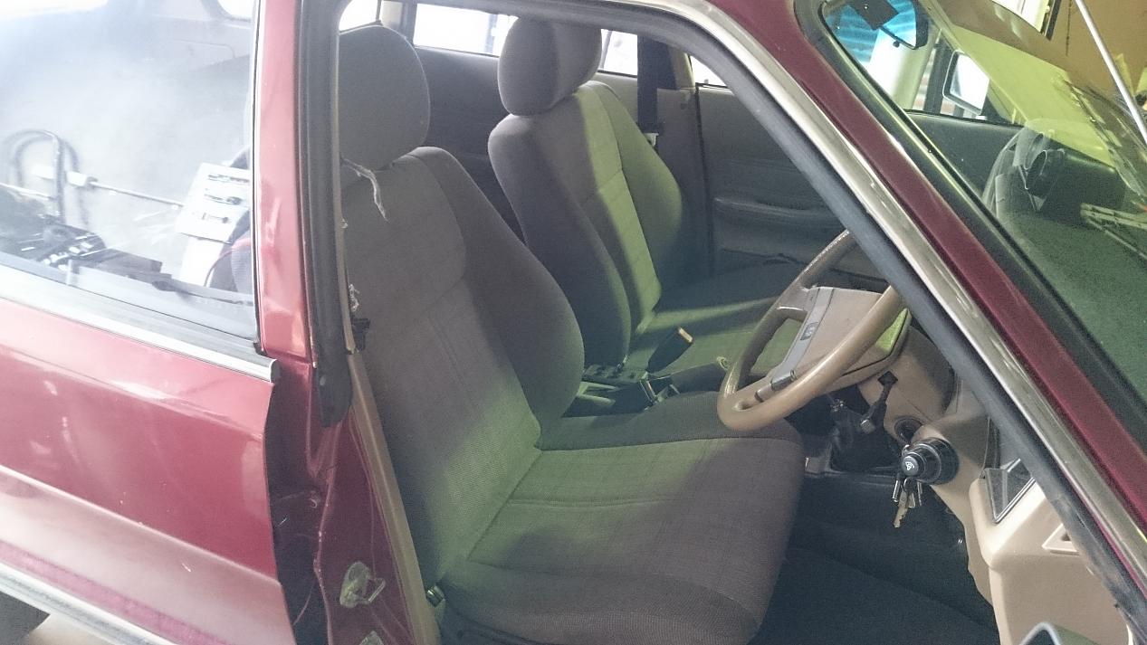

Also got his old Lib seats and installed them in the wagon. Orders of magnitude more comfy then the old MY seats. I ended up adapting the MY seat rails to the lib seats. Tight squeeze but they fit.

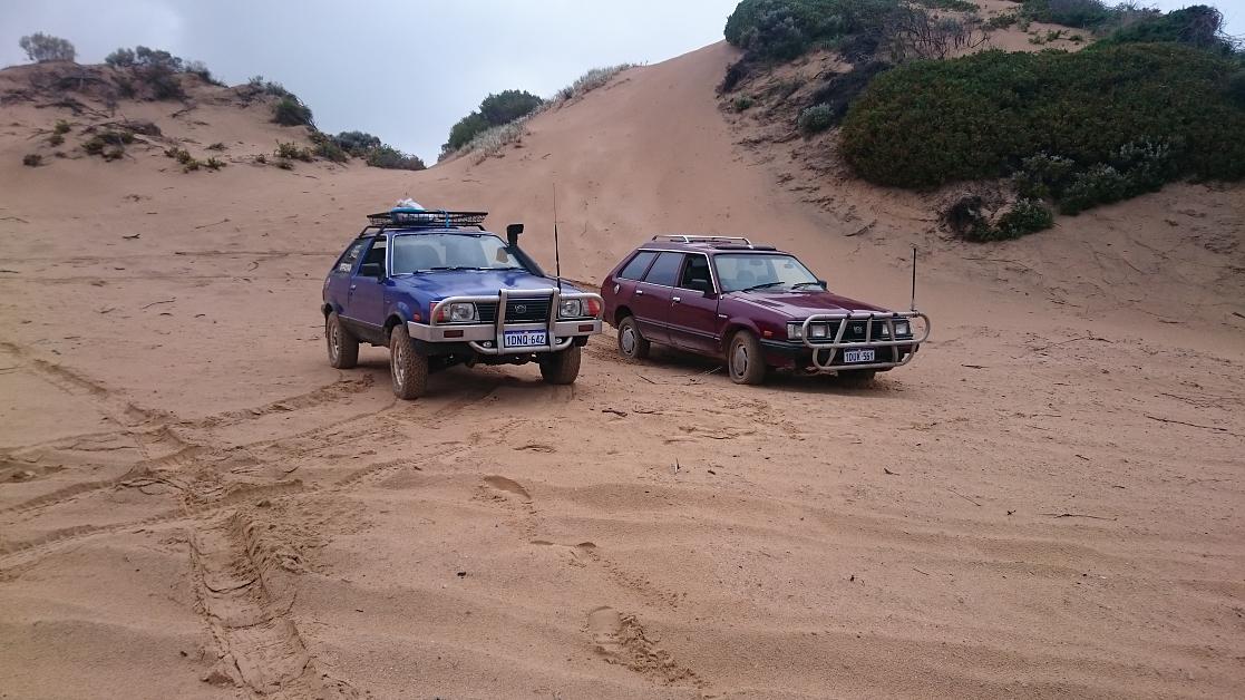

And a couple of MY's in the dunes,
Both are completely stock :twisted:.

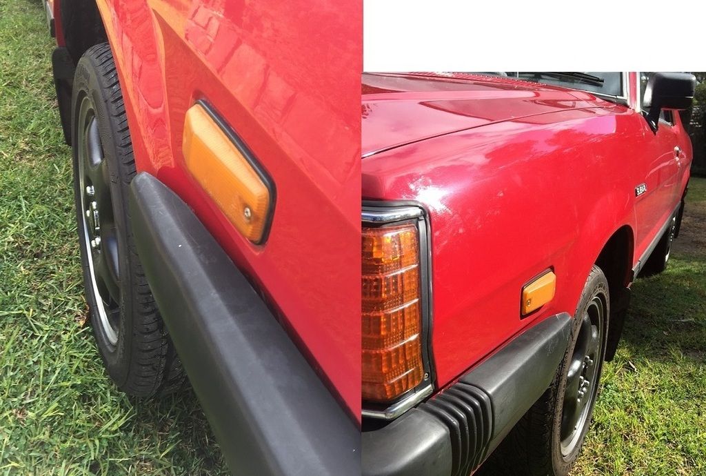

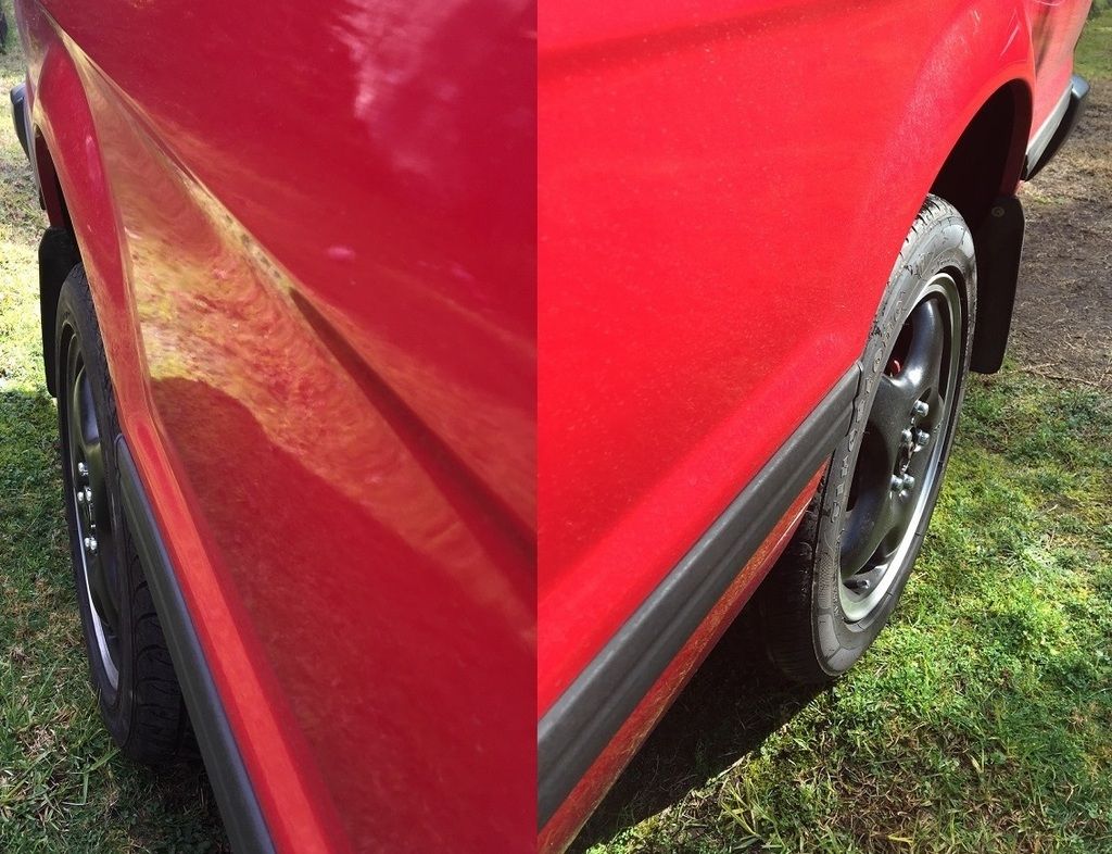

Fitted some 20mm spacers behind the Impreza 15" alloys on the Brumby:
(Left side is with spacer, right side without)
It may not be hella flush :), but looks a lot better than before and handling is noticeably improved.

They do look fantastic, just don't let the cops see dfoyl! :twisted:
