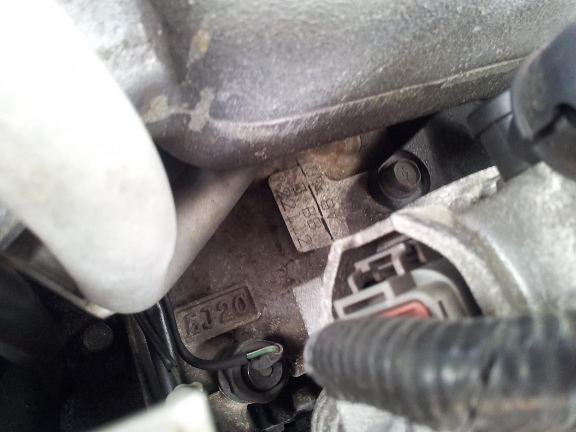

Just to clear it up, it does have the correct engine number listed on the Rego, the 6 numbers from the back, left hand top of the engine block, near the bell housing?

We haven't received the registration papers for the car from the government yet. They SHOULD come within the week. On the REVS sheet, the engine number stated on there is the engine number located below. It has the 10BB22112 as the engine number but does not mention EJ20 (weather it's meant to or not)
[ATTACH]3806[/ATTACH]
- 20121228_175443.jpg (92 KiB) Viewed 5457 times
Yeah, I thought you mentioned the etchings in an earlier post, sorry man but that's not the engine number aye, they're build specs for the block.

Yeah, I thought the engine number should have started with EJ. The EJ20 part is the most important.steptoe wrote:and someone has allegedly successfully and incorrectly supply and record those numbers in the engine number space of an application and looks like it has continued on - I don't think any state has a checksum data checker to cross check supplied engine number with that supplied, although it might be up to the staff processing to check , as I know at least two states insist that Subaru engine numbers must be supplied in the format EAxx XXXXXX or EJxx XXXXXX or the human rejects application, raps inspectors knuckles.
