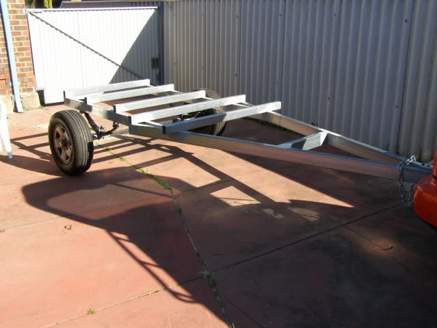

yep, one day. was on a roll this morning. got the chassis welded, started bolting it all together, packed the hubs with grease, put the bearings in, checked the seals... they've given me the wrong ones. now i have to drive all the way back to bayswater to swap them over... not happy at all

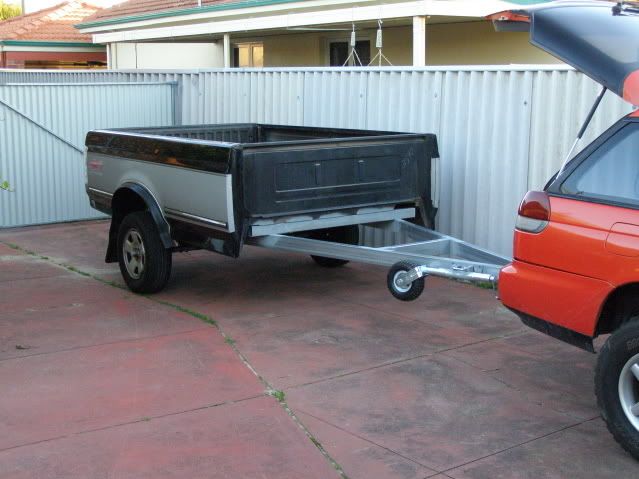

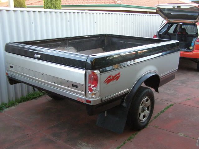

Back on topic, i've just dropped the well body onto the chassis and its HUGE!!! wasnt expecting it to be this big. makes a ridiculous trailer but will be good for an offroad camper thats for sure:)

It's bigger than my car. LOL

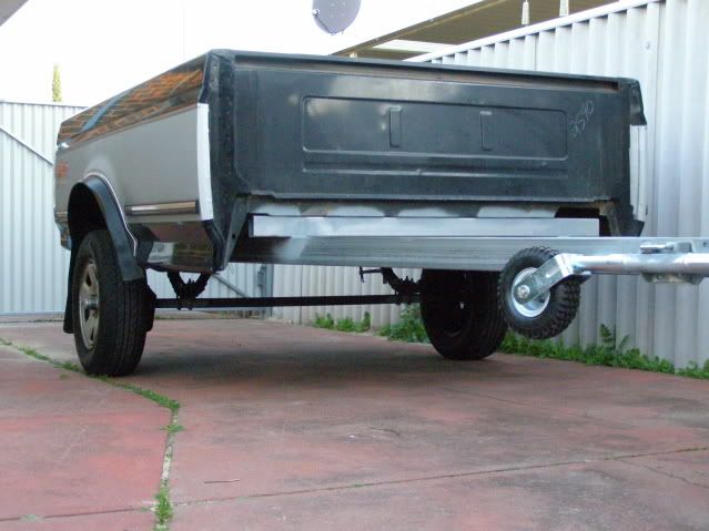

my local trailer parts supplier can drill whatever stud pattern you want. I had to get the hub machined a bit because the rim didn't fit over it. The standard hub with ford or holden stud pattern was $22 for the pair, he charged $27 for the pair of custom drilled ones. also got that jockey wheel for $53 courtesy of their little stuff with the inner sealsSuparoo wrote:More pics please, that looks awesome!!!

Now im just trying to find some matching rims and tyres.

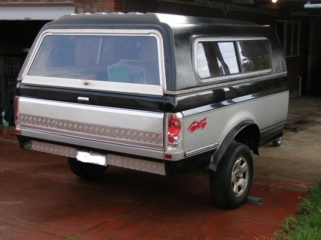

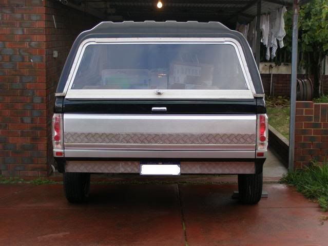

here's the canopy bolted on... just gotta put something on the front to enclose that then she's finished for now. looks like i'll have to up grade the axle, down grade the springs. loaded it up last night with moving stuff and it looks a big saggy. i think the distance of the springs to the wheels is a wee bit too much. currently its got a 40mm axle and 1 ton springs, gonna get a 500 mm axle with 750 kg springs and see how that goes. at the moment the suspension doesn't budge which is putting a lot of shock through the axle... But thats next week or the one after
