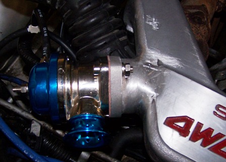

your welder prob doesnt have enough juice for aluminium mig welding. i've got a cigweld 200amp, and 6mm al is working it hard. i spose you can give it a go (welding aluminium is fun!).
imo the best thing about welding al is it's easy to file back your mistakes! hahahaha. it's very similar to mild/stainless, however it is very important to get the al melting before you move on (unfortunately this usually leaves a large unsightly dag at the start of your weld).
and you'll need 100% argon for the gas too.
here's a quick pick of my blow off valve on my rx that i welded on (and filed back - still not finished)

twilightprotege wrote:your welder prob doesnt have enough juice for aluminium mig welding. i've got a cigweld 200amp, and 6mm al is working it hard. i spose you can give it a go (welding aluminium is fun!).
just checked the pic... nice one!
