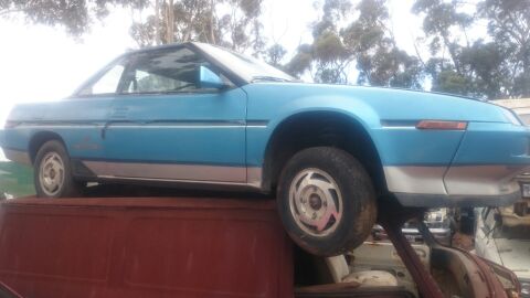

G'day blokes,
I've found what I think is a rising sun import at my local wrecker and it seems terribly complete. I should have checked if it has coolant in the right places but the photos will have to do for now...

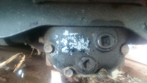

I realise there is a 3.7ratio LSD/disc rear that'd go well in a wagon, but what else here is of value? Turbo, crossmember, power steer... Not being terribly familiar with these things I wonder which intake manifold is it. Is the Turbo engine is decompressed with different heads or pistons? Do they have oil squirters. Is the Turbo engine still a non interference design if it busts a cam belt?
I'm about to do a bit of a rebuild on the front of the wagon, swapping struts, power steer boots, clutch, drive shafts. If I was mad enough to swap the whole crossmemeber & engine, could this auto donor be fitted with a manual trans? Or do I rip the engine management out and fit an SU carburettor. That sort of thing really appeals more to me than electronics.
Anyhoo I guess what I need to know I'd what to pay for it & wether there's a market for the bits. It's all a bit long in the tooth there days but the back end is what piqued my interest most.

What's wrong with the car? Why is it at the wreckers in the first place? I look at that and see a car I could bring back to working condition. So sad.

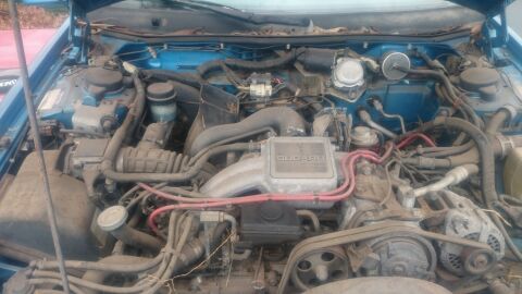

That is a spider intake manifold and yes the turbo EA82s have lower compression, but it's crazy 80's low compression (7.7:1 from memory), lack of intercooling and 80s ECUs made manufacturers conservative with compression. Personally speaking I wouldn't bat an eyelid at putting a turbo on any EA82 if I had the right ECU setup and tuning, run good fuel and avoid knock at all costs.

Its a locally bought Vortex.
It will have rear discs that will fit the L series, but don't assume it has an LSD, as Vortex's usually don't.
If it's auto it wont have a center diff lock.

I'd like the brakes and LSD (if I read the sticker right?) for the wagon. The turbo donk would be cool too but I haven't much time to bite off another whole project and then again young Maggie would rather I saved for the joint wedding account, so perhaps the whole lot would be up for grabs. That might win me some brownie points for being on the PC typing away at car forums... lol.

The intake manifold is desirable, as is the air flow meter and possibly the ECU.
Engine & crossmember aren't really hot property because ej.

The crossmember is valuable because it has the turbo notch BTW.

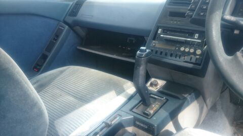

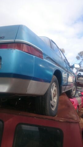

Ok blokes. More pictures. Wiper module is there;) Wiper motor is there;) Found (all?) hubcaps in the boot. DS door is straight, rest of the panels are good to fair. It wasn't -full- of coolant but what came out was nice & green with no sign of oil. Diff is not LS but you already knew that...
I suspect it's at the yard because the steering column is ****ed. Steering wheel spins completely free & some attempt has been made to remove/disassemble the column, but they gave up without getting the wheel off.

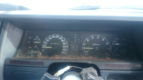

Radio is a bit tatty, dash surround has a bit broken from the top LH corner of the instrument cluster but the rest looks ok I think. All the parts seem to be on the back floor but I didn't manage to see if the column shrouds etc are unmolested.
Drivers door trim is in the boot, not sure why. Instrument cluster is dirty but the window isn't stuck down so I don't think it's been wet.

Yes, 4 speed electronic auto wth lock up TC, very good transmission.RubysueEA82 wrote:So it's labeled D, 3, 2, 1... is that a 4 speed auto?
