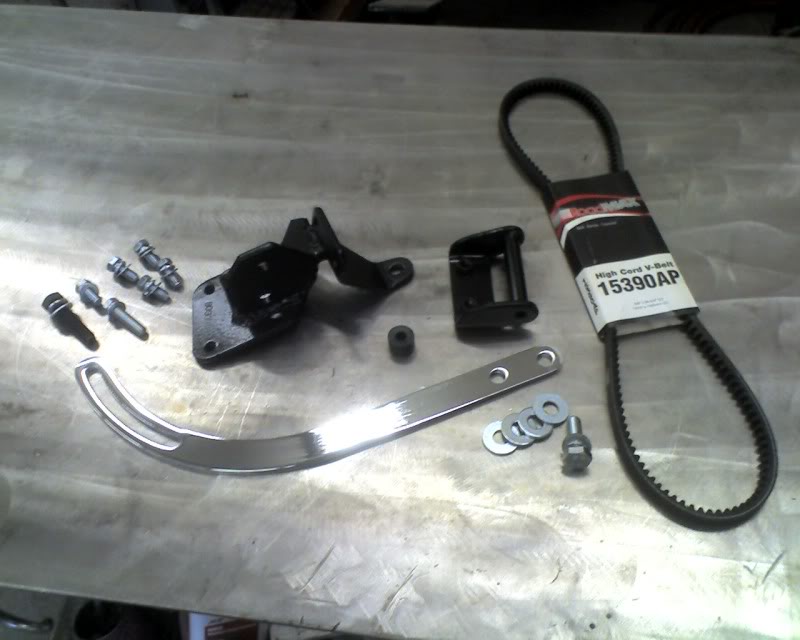

TOONGA wrote:Use the EA82 PS Pump :) The turbocharged Jap EA81 used a similar unit.
I've never seen this done without the turbo bracket and crank pulley. It'd be interesting to see if it would work.
coxy
Posts: 149
Location: Sydney/NSW
Post by coxy » Sun Mar 13, 2016 8:28 pm
This will do it so it is possible
EA82 power steer pump to EA81 kit.jpg (55.79 KiB) Viewed 6842 times
Posts: 12699
Post by El_Freddo » Sun Mar 13, 2016 8:48 pm
Does this work with AC? And where do you get this kit from?

Post by coxy » Tue Mar 15, 2016 9:08 pm
Kit comes from one of the USMB members where I have been banned for some crock reason related to spam (Spare me the BS)
I am borrowing the idea for my Brumby and seeing as I have full fabrication equipment going to make one for myself and yes I have just picked up MY Factory Air for a bargain Hundred dollars so I will make sure it works with AC.
Busy with new Job but will sort it out over the next few months or so and keep you in the loop, May as well make a few after I sort out the prototype.
