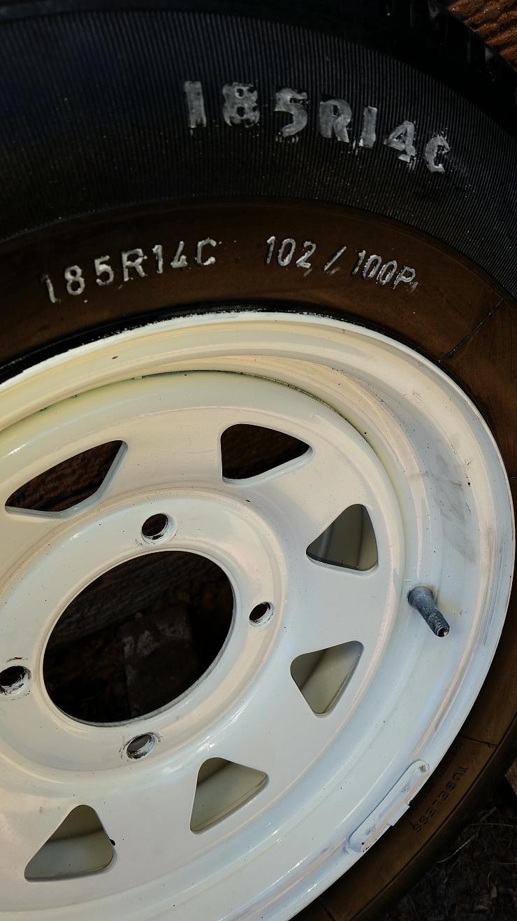

Post by Gazza01 » Sun Jan 18, 2015 8:39 am
[ATTACH]4539[/ATTACH][quote][URL= I bought a set of 14 Inch speedie/Sunraysia rims and tyres complete. The tyres are 185R x 14 and if I put them on my Brumby I know from the previous owner that the front tyres will hit the back of the tyre well when I make a turn. Have any of u Guys out there know what size tyre I should put of the 14 inch rims so they will clear the back of the front tyre well on turning. The 185R and a BIG tyre when you look at it.

Its the 105 profile that is the problem ( I think)
I have 195/65/14 with no problems
read
http://www.ausubaru.com.au/showthread.php?t=24979
there you will find also find the largest so far on a L is 215/65/14s
Post by RSR 555 » Tue May 05, 2015 9:51 pm
Old school tyres didn't use the profile because they were all one size. These were all 75 profile, so these tyres would be 185/75R14 and will be a tad high but would be fine if you used rims with the correct offset.
