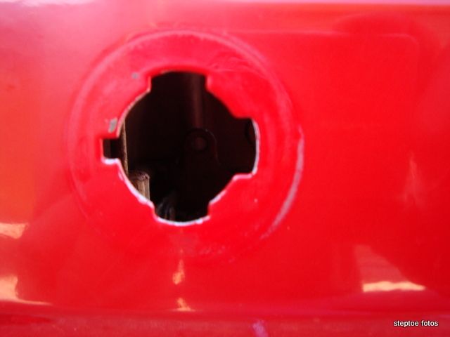

and, for those wondering, NO change to the hole in door to accept the Solex lock of '99 to this pic - for RHS door
here is the outside pic anyway :p
Image,Image

The mods ?? Think it was the three and nine o'clock slots you see in pic above.

There are no mods to the hole or slots of the door skin to fit these nice locks in place, fit straight in once the dog bone is in place and the included pull lever retainer thingy.
