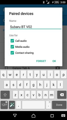

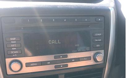

I assume you've got a 2010 Forester Diesel base model similar to mine, with factory standard head unit. In that case the standard head unit doesn't do any bluetooth or Ipod linking. The only input is an aux input for a standard headphone output. This is located at the lower back of the centre cubby between the front seats. This cubby should have a small tray with a slot at one end. this tray sits at the top of the cubby with the slot pointing forwards. It's designed to hold an Ipod (or similar), with the slot for the cables out (to the power outlet and aux-in input, both below.RSR 555 wrote:...and I've got to look at a way to connect her Ipod to the head unit. It appears to have some bluetooth handsfree thing, which I'm not sure if it's genuine or not?
It's possible the bluetooth thing is a standalone handsfree unit. It may link in to the mute function through the radio harness.

It is the base model but the previous owner was Subaru WA, so it has a few extra bits in it. I know the handsfree definitely comes through the stereo but it has a little mic up near the driver's visor. I'll learn more about the car when I get to see it a bit more. I might even look at getting Mum one of the samepitrack_1 wrote:I assume you've got a 2010 Forester Diesel base model similar to mine, with factory standard head unit. In that case the standard head unit doesn't do any bluetooth or Ipod linking. The only input is an aux input for a standard headphone output. This is located at the lower back of the centre cubby between the front seats. This cubby should have a small tray with a slot at one end. this tray sits at the top of the cubby with the slot pointing forwards. It's designed to hold an Ipod (or similar), with the slot for the cables out (to the power outlet and aux-in input, both below.
