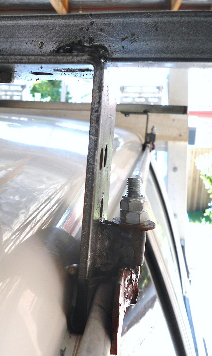

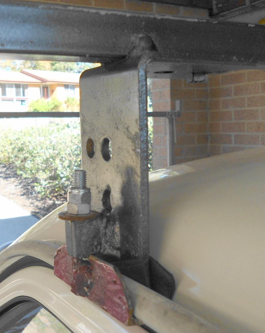

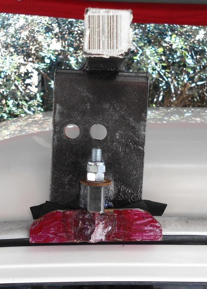

You could make up a couple of roof racks like I did . angle brackets height to suit then weld small tube to bracket then weld bolt to a small piece of 20-25 mm angle fit bolt up through tube on larger angle then do same on other side then we;d square hollow section to large bracket. one done now repeat[ATTACH]4417[/ATTACH]
[ATTACH]4418[/ATTACH]
[ATTACH]4419[/ATTACH]
