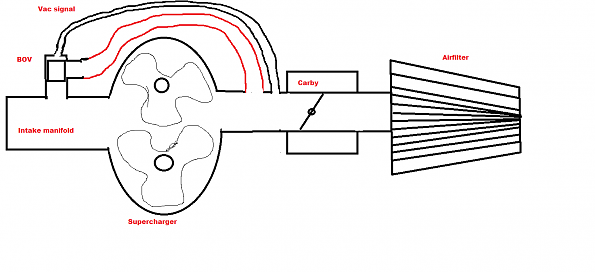

Post by Subydoug » Thu Feb 07, 2013 4:46 pm
This is what I think tweety. Id give that a go before anything.
Doug
