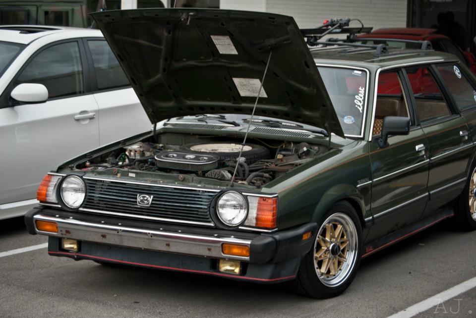

Sounds like a fun but challenging project though. Love the look of the round headlights
[ATTACH]3898[/ATTACH]
Frothing on this wagon.
