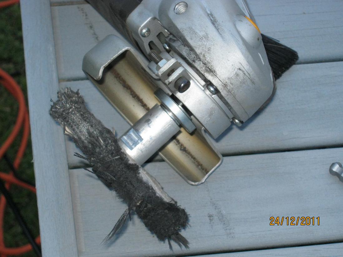

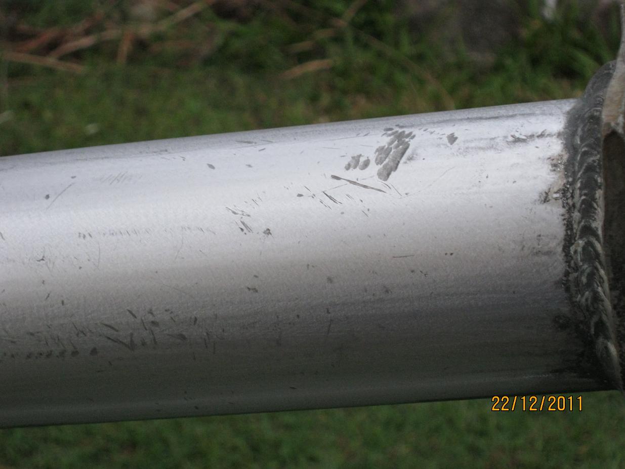

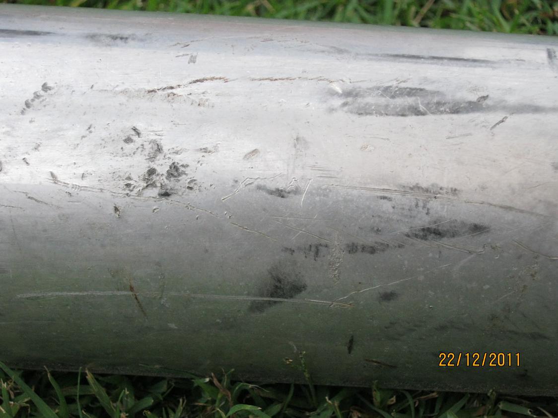

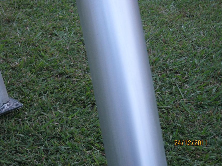

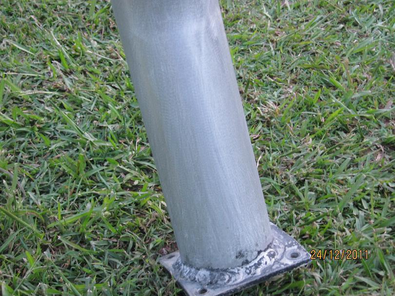

Spent some time rubbing back a second hand alloy roll bar. It had some heavy gouges and scratches in it.
Bought a Royobi One orbital corner cat sander.
first rubbed the whole bar back with 120 grade to show up all imperfections.
Then rubbed the imperfections out with 80grit. This took some hrs, probably 4 hrs in total but I got a break between battery charges and I done it over a few days.
ATM rubbed the whole bar(am only 1/3 of the way though at this stage) back with 240 grit.
Also turned up and adaptor to take a cotton wheels on a 4inch grinder for buffing.
Photos show different stages. Far out there was some work rubbing out the scratches and gouges and the Royobi has earnt its keep.

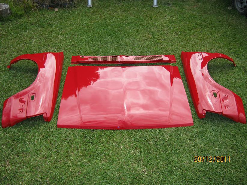

Put some hrs in yesterday rubbing back guards, grill and inside of bonnet.
1 guard and grill painted, almost fininshed rubbing the other guard and will try to rub the top of the bonnet and finish off the other guard today. That is if I don't go to work to bast and paint another set of sunrasia rims.
Nice Brum Smash
yesterday fininshed off the bonnet and one guard.
today blasted 4 sunrasia rims and am in the process of undercoating them with etch primer then 2 pack white if the weather holds out.

Awesome revmax!!!revmax wrote:
Thanks fellas. I am an amature or back yarder (first time) but are utalizeing our customers and work colegues for knowledge and know how.
There are some blemishes but I should be able to polish them out.
my spray booth consists of a 3x3 marque in the back yard. LOL
The sunrasias are coming along nicley to.
I will post some befor during and after shots soon.

Cam. Yer mate wax n grease remover for sure. most of the blemishes are foreign particles from my back yard spray booth. I am thinking 1200 wet and dry then polish but I will consult with customers and work colegue who paint stuff for a living, before I do anything.
- Brumby Kid
- Posts: 1297
- Location: Belair S.A.
Yep 1200 should do it if it's just foreign particles.
Then a nice wax and polish should be great for it!
They look awesome revmax, great job.
Remember you will always be your own harshest critic when it comes to your own work. I think you should be really proud of the job you've done, esp as you say its your 1st time!
Yer sure. The 2pac primer and top coat are Valspar brand, it is sold an Industrial 2 pac and is pretty cheap. $140 for 4L of colour and primer ea and the hardner was about $38 for 1L ea. which will give a total of 5L each.steptoe wrote:2 pack in the back yard - alright, thought you had a booth and oven !
Wanna supply some details of what you used, like brand of unnercoat, top coat, how much in dollars and quantity - colour code for Brumby red ...please
so it is $178 X2. The paint code is 946 Rio Red. I think, will check in a minute.
The real secret to a nice fininsh is in the rubbing of the undercoat. A small orbiting sander,orbits of no more than 1.6mm and use the white abrasive pads 240grit and BE patient. I should have used a 1/2 sheet sander on the bonnet instead if the old GMC corner cat sander I have. (mum bought it for me some 6 years ago and I have used it once for 2minuets since I have had it)
2pack is real bad for ya and breating aparatus is advised.
For the big dints I used a good quality boddy filler and for the small dints used spray filler. the spray filler needs good time to dry properly and I made the mistake of trying to rub it before it was set properly, it did rub but the surface texture was not consistent and had to put an extra layer of paint over these areas to try to blend it, it mostly worked and I am hoping the 1200 WnD will knock the tops off the blemish.
