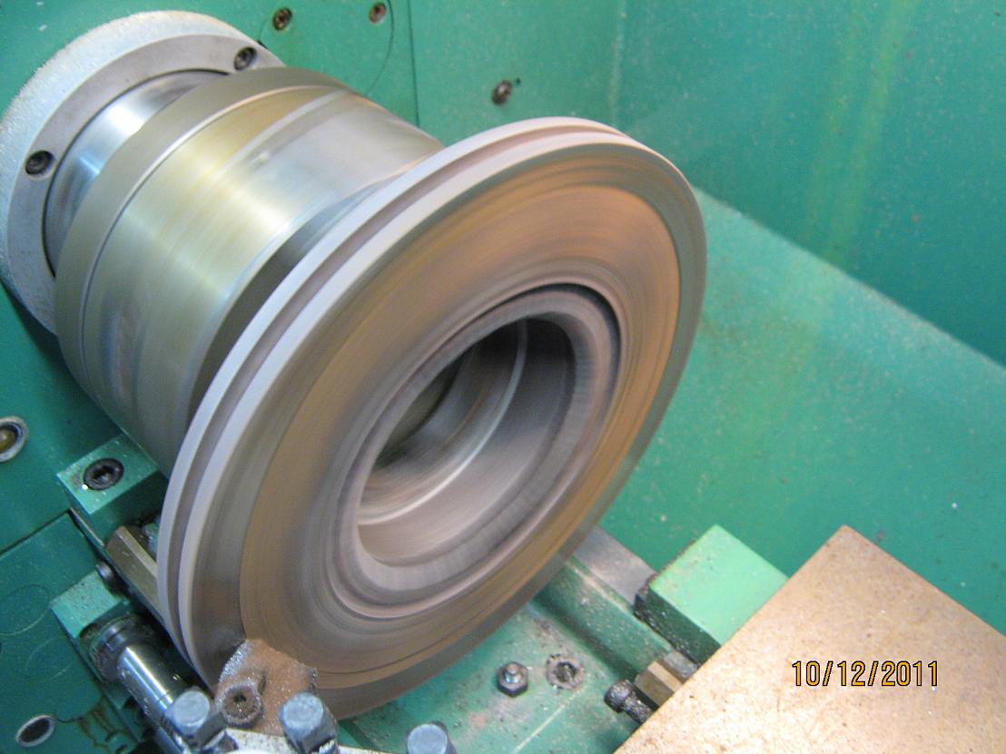

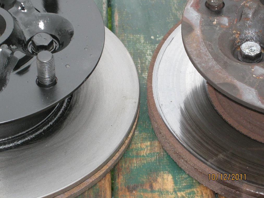

took out he "Swish Swish" noise from the front disc brakes.

Hey revmax, that's interesting what material are the discs made of? Just curious since I doubt it would be plain MS.

Brake discs are Cast Iron.
I machined the dics from the Brumby I recently wrecked, Blasted the wheel hubs and disck hubs then gave them a quick coat of sattin black.
so when I changed the discs over it whas a quick changeover. I will machine the discs that came off so they can be fitted quickly if ever need be .

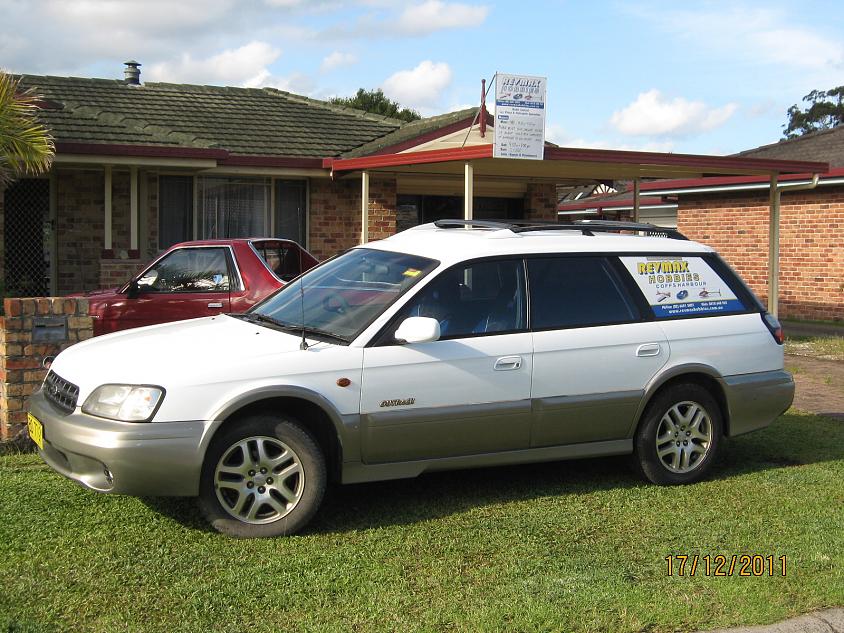

Outback got a wash and wax with nu finish once a year car polish.

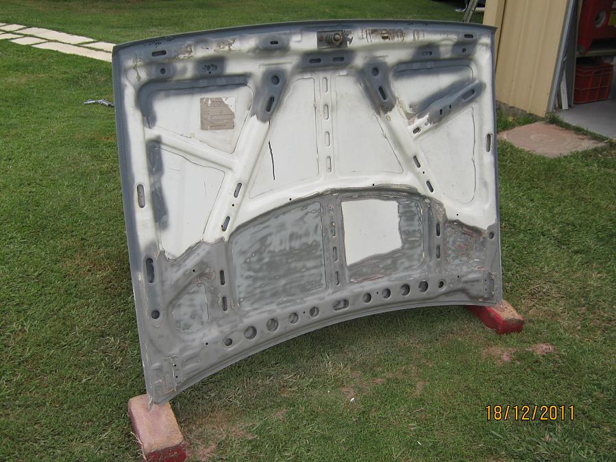

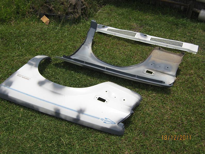

done some blasting and prepin of the front guards , bonnet and grill for my Brum. more work on these pannels tomorrow. Had to stop cause I wore out my last blasting nozzle and gunna try some ceramic ones tomorrow, Hope gasweld has some.
OH BTW I bougth a 3HP 346LPM air compressor from gasweld and now my blast nozzles only last a little over 30minuets.
I have decided to fix this bonnet. Blasting the underside to remove the resprayed acrilic paint which is coming off pretty easy anyway. If i dont remove it it will peal whan I spray the 2pack. I can rub the top surface back pretty easy with my little orbital sander.
One of the front guards I got off Gannon the other from a wreck, they will both get rubbed back but one needs some welding first.

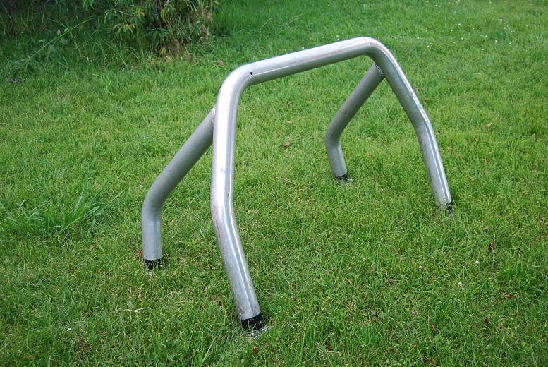

Brum is getting a Bar.
Roll bar that is.
Picked up a 3inch alloy roll bar today and some extra sunrasia rims.
The bar needs a good rub back, holes welded up and a polish, I may even 2pack clear coat it.
BTW went for a Drive to Taree today and back 472km on 32.3l = 14.6km/L (FAR OUT)
