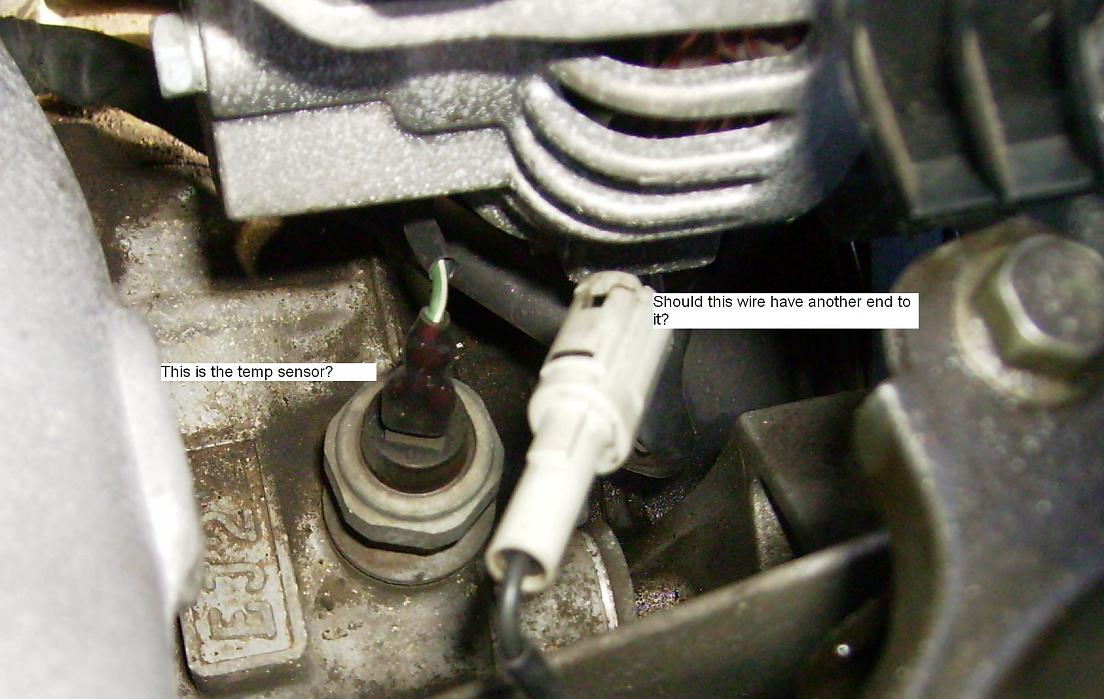

just wondering what this wire with no apparent home is?[ATTACH]2781[/ATTACH]
[ATTACH]2782[/ATTACH]
temp sensor.jpg (101.52 KiB) Viewed 5623 times
Post by TOONGA » Sat Jul 02, 2011 4:19 pm
sorry that is the oil pressure sender
the temperature sender is under the intake manifold on the drivers side on a cast aluminium pipe that runs from one side of the engine to the other.
where the arrow is pointing (my intake manifold is removed in this photo)
the other connector looks like a knock sensor or cam angle sensor connector

Post by Super ruby » Sat Jul 02, 2011 5:50 pm

TOONGA wrote:the other connector looks like a knock sensor or cam angle sensor connector
I thought that these were longer so that they are connected and mounted near the bell housing...
Also I don't think the EJ will run without the cam angle or crank angle sensor connected.
^ This is the temp sensor for the ECU. It's located below/under the intake manifold on the driver's side on the coolant passage - you have to access it from the back of the engine to see/get at it. You'll most likely have to remove some of the PCV pipework (crank ventilation system) to access the temp sensor.
The temp gauge sensor is also in that area, this gauge has just one wire similar to the wire that mounts to the oil warning light sender unit in the pics you've given us.
The ECU's temp gauge sensor has two wires and I think a brown plug as per the pic above.
^ The sensors will be under all of this - I don't have a photo to show exactly where they are, but if you compare this complete engine to the pic of Toonga's intake-less engine you should be able to work out where it is ;)
