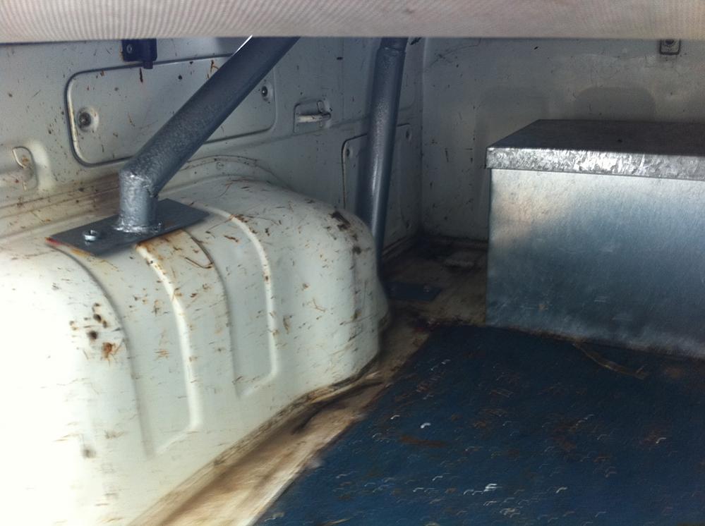

Here are a couple of photos I snapped of the tray - a little rust, doesn't look too bad to me

It would be interesting to know what it is like underneath the tool box. I haven't got a tool box but in that location in the tray (just behind the window) is where my worst rust spot is, and I believe is a bit of a weakspot due to the higher chance of weather getting through the Tonneau cover there.

pfft, that ain't rust it is surface rust, should show you my rust that has been there for over 12 years and 350, 000km !

Yeah those pics aren't really bad rust. Rust is when you can see the road from inside the tray:P

Yep.. that's just surface rust. Make sure under that carpet/mat all is ok? rubberized mats in the back usually sweat and cause rusting so have a quick look. The main rusting spots on the Brumbys are the rear wheel arches, bottom of the front guards near the doors, inside the door frames near hinges and bottom of the doors themselves, the chassis rails (under the car) where your feet sit, the tailgate, around the front windscreen and in the spare wheel well.
