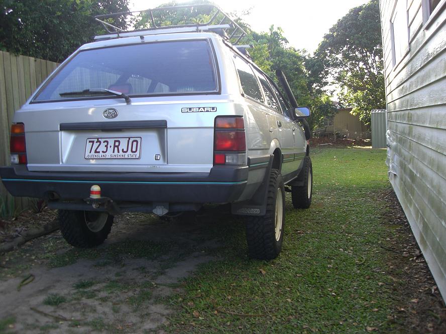

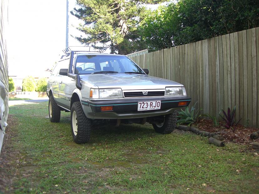

Well the old sedan just wasn't doing it for me anymore so when a cheap L wagon came up as a trade in at work i grabbed it. It was a 92 auto 4wd drive wagon now its 5 speed dual range with a 4 inch lift and 27" muddies. Its great being able to fit my fridge and my camping gear into the car. Still playing with the snorkel at the moment....is there nothing you cant get at bunnings? Any way I thought you guys might appreciate it. Oh yeah if any body in brisbane has a bull bar to suit I would be real interested.

very nice & rather neat, it looks like it belonged to another member? EJ motor in the wings?
Post by El_Freddo » Thu Feb 10, 2011 9:15 pm
Very neat. I'm starting to think the 3 inch is inadequate!

Now that is how i want my soob to sit!

Just a quick one dude, I notice on your pic of this beast that the snorkel inlet is facing backwards. Should face forward for better inlet charge:)

There has been quite a bit or research done on ram air intakes, lets get one thing out first, yes they do work but only at high speed and with correctly profiled intake point and ducting. Most snorkles vary in diameter and have several points that introduce turbulance to the airflow in the air flow, ie it kills flow. Now engines are just air pumps and as a result create negative pressure on the intake side which is quickly filled by ambient air pressure some where around 14.5 psi depending on conditions. Your just not going to improve on this with a forward facing scoop at road speeds, if it did you can bet that every manurfacturer would have it fitted already. Manurfacturers are more interested in getting cooler air due to it being denser. I fitted the scoop due to drowning my sedan, i caught it before it did any damage but it was close the filter was soaked and had mud in the air box. Forward facing scoops tent to gather more muck into the intake and also water when it rains. Rear facing scoops force the air to change direction as it enters and therefore helps and dust or water to be removed, much like a pre filter on a Donaldson etc. Besides no amount of air is going to make a L series on 27" tires a road warrior........thats what EJ22's are for. lol.

No arguments from me i had thought about that also. It would be fun to put a manometer ino the intake and check some pressures (negative or otherwise). I'm pretty sure that the suction generated by the engine would far out way the effect of air flow past the pipe, I have slash cut the end of the pipe to keep the rain out but also make the opening efectivly larger. Its early days though I may play with it a bit as i go, its not my daily driver i have a subaru powered Volkswagen for that, so its mainly just used as a toy and for camping etc. My main concern was keeping water out as it didn't cough or miss when i submerged it i just found the wet air box while checking it back at camp.

Sorry FujiFan, I didn't mean to come across as narky...lol. I appreciate all comments, its the best way of getting new ideas. I am tossing up about putting a pre cleaner on top of this as some forrestry trails can be real dusty and they sure do help getting rid of the bulk of the crap in the air. The whole snorkle owes me about $30 bucks and is easily repaired or modified with a quick trip to Bunnings. The lift is great, it saves alot of body damage but the clearancr under the drive train is only up by the increase in tyre diameter. The best mod by far has been the CIG locker, it is the best thing i have ever done to help off road. If your looking to do some wading spend some time sealing the motor and the electrics, seal the distibutor and tap it for a breather pipe high in the engine bay and rout the emmision air intake up high as well. Water will stop it eventually but you will be surprised how deep you can go. I hope your not fussed about your carpet.................
