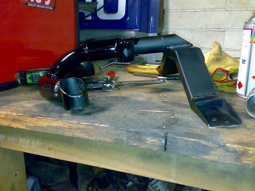

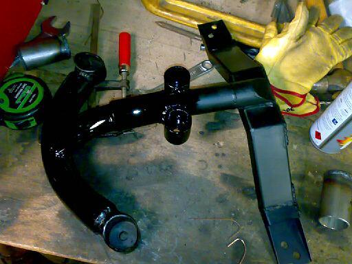

Hi there fellas just wanted to see if there is any interest in ej into brumby gearbox cross member.....i fabricated one as a test and wanted to see if any one has any interest....this one is mostly tube and 25x50 rhs but the new ones that i have on the run now will be 6mm by 50mm flat bar bent and 3mm gussets all tig welded together........garanteed not to break....i wos thinking of around the 300$ mark but you guys tell me wot you think and ill go from there..........his a pic of the tube one.......

tell me y u are tig welding it when u can mig it up faster and just be as good

for starters a tig weld gives far more strenght than a mig weld and its prob a little longer to tig than mig and second a good tig weld looks far better than dirty mig weld.....
but im not biased i can mig it to and you could prob save 20 bucks.....

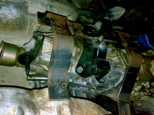

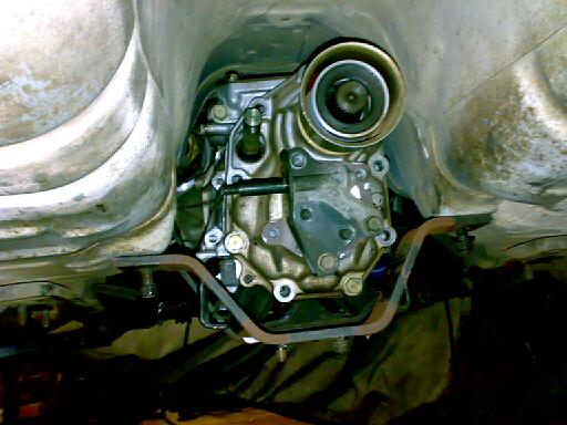

I'm definitely interested. Is it possible to get a photo of the bracket in position with a gearbox. I am still trying to get my head around exactly how it fits/sits.

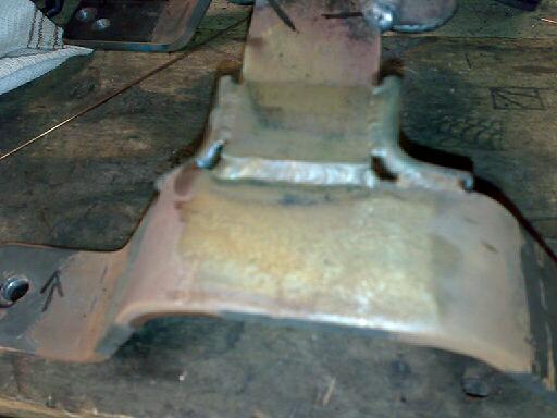

just have to say guys thanx for the replys and all the work....since being on here i have sold 5 of them.....so dont be biast now im makin them in flat bar now and still garantee that they wont brake...if so ill replace it... ill post some pics up prob on the weekend or so of them .........

from my understanding it bolts to brumby gearbox member mounts at front and sway bar mounts at rear.

yea the front part is good (the diagonal bolts eather side for the factory xmember)and the rear goes back to the back of the gear box area there is 2 lugs welded into the floor(same as l series kind of)havent seeen them being used on brumby but maybe leone coupe auto mount....) ill post up some pics of the new one and where it mounts....

bein so flat outand cant even get time to wipe my ass(new born in the house) but here is the pics....
