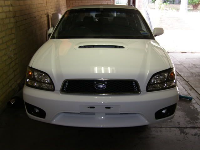

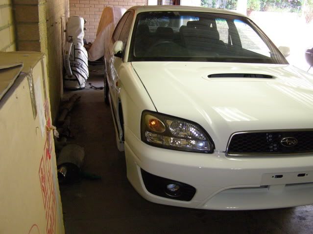

Post by vidler » Wed Dec 10, 2008 7:01 pm
here it is with the panels on. rest of the car needs a cut and polish to get it to match but should come up good
09 Forester XT Touring Wagon

Post by vincentvega » Wed Dec 10, 2008 7:35 pm
bonet lines are good. must be straight.
again well done
